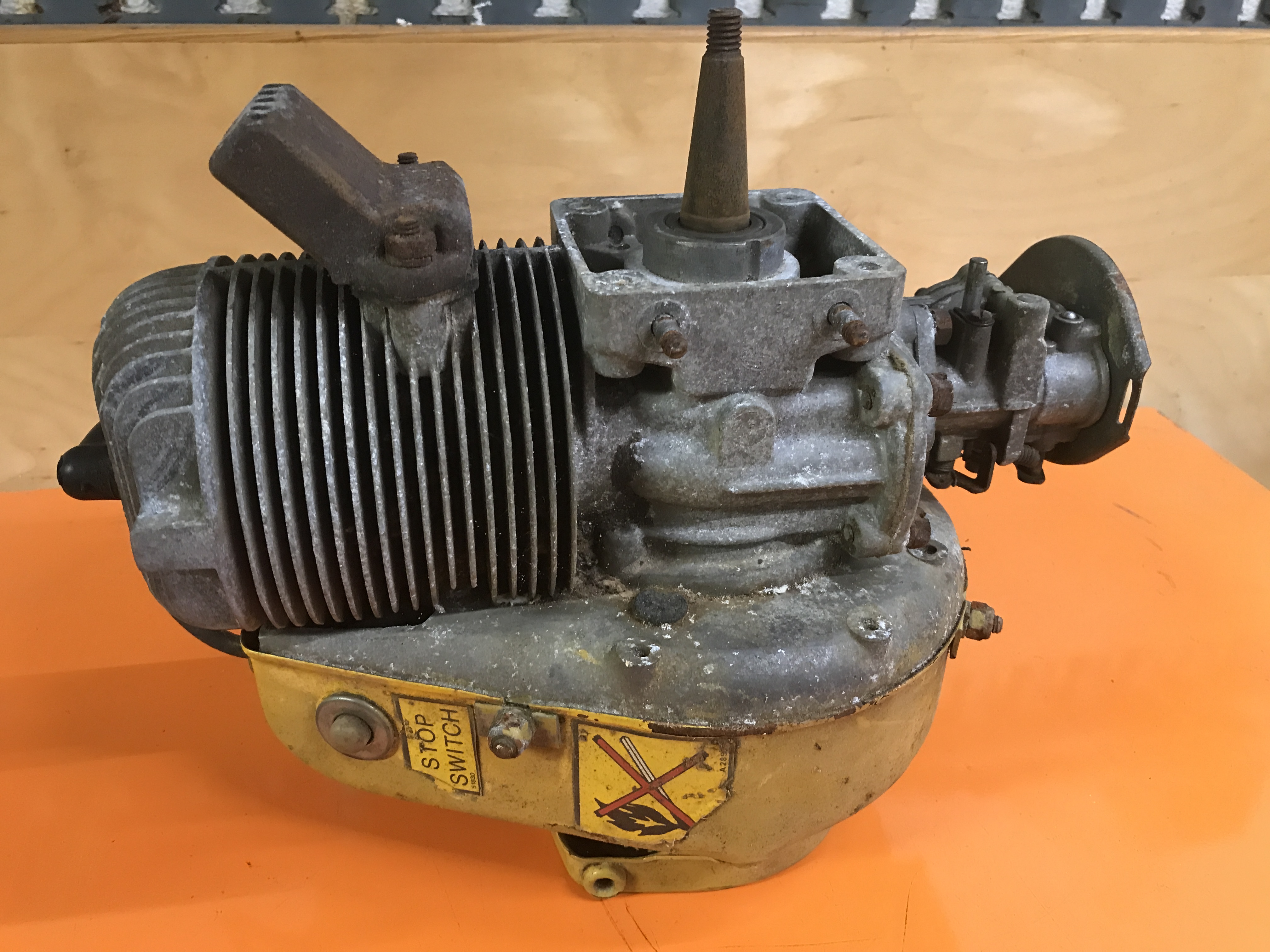

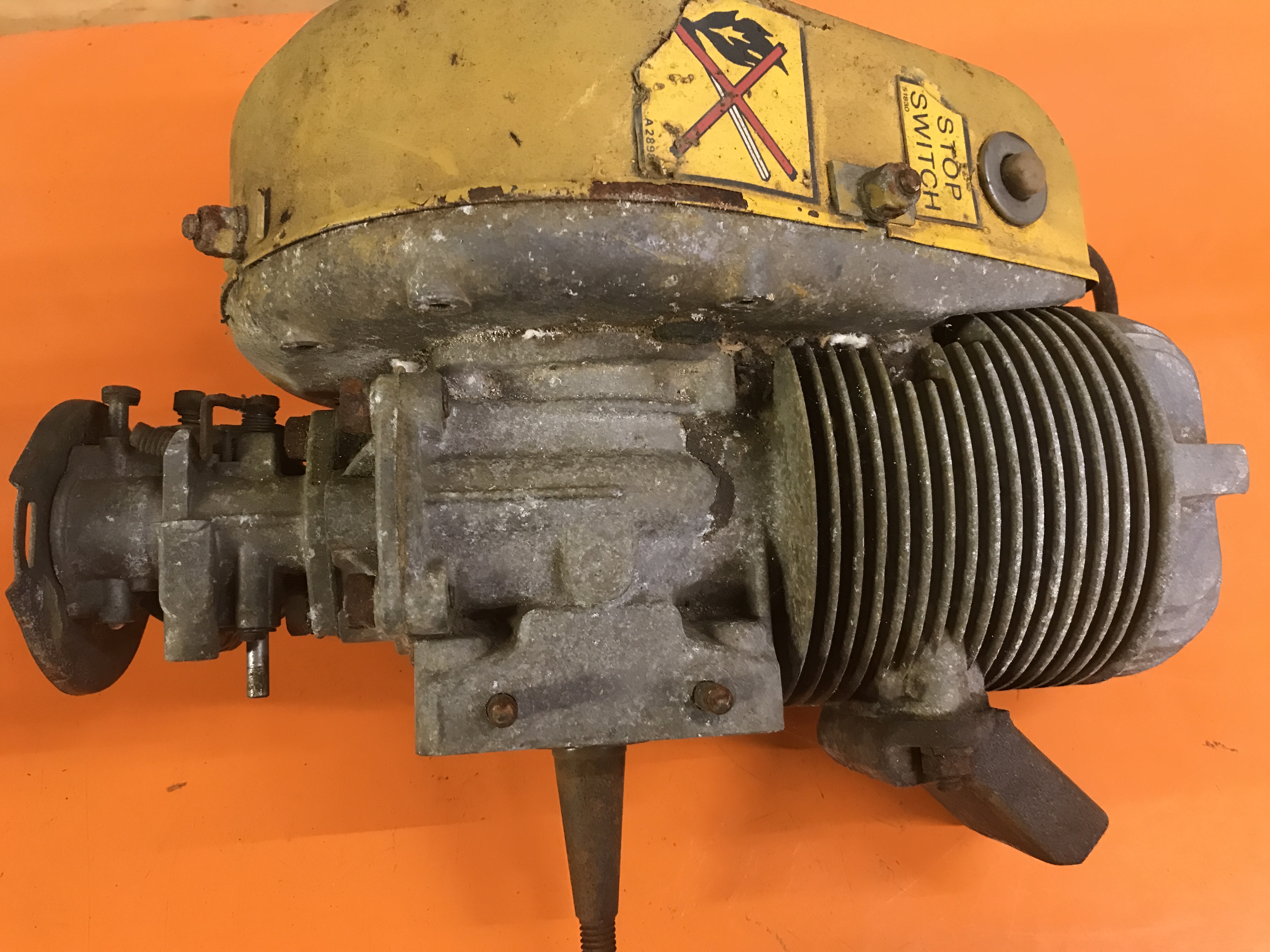

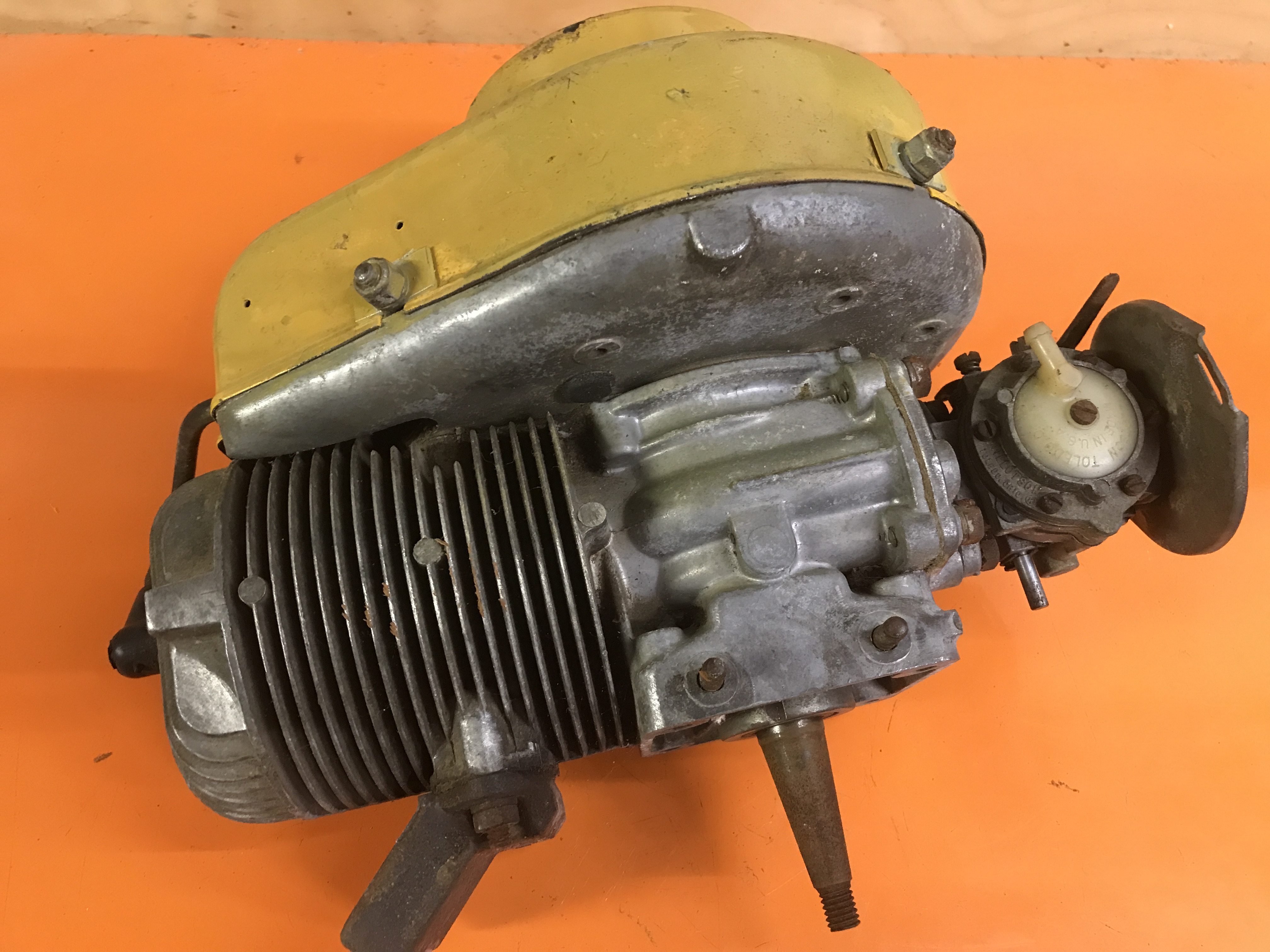

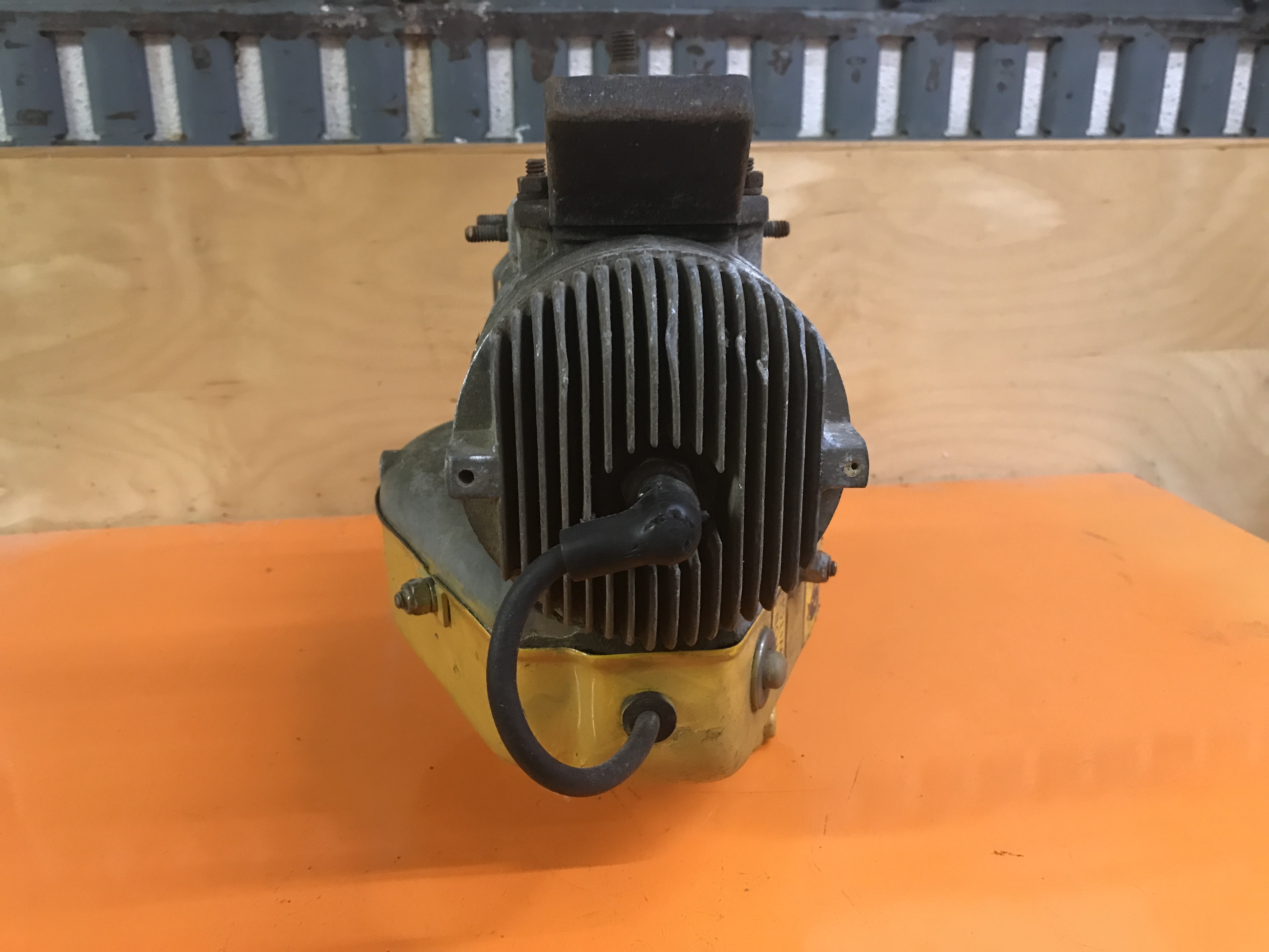

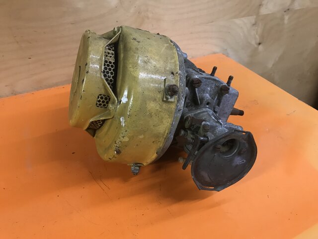

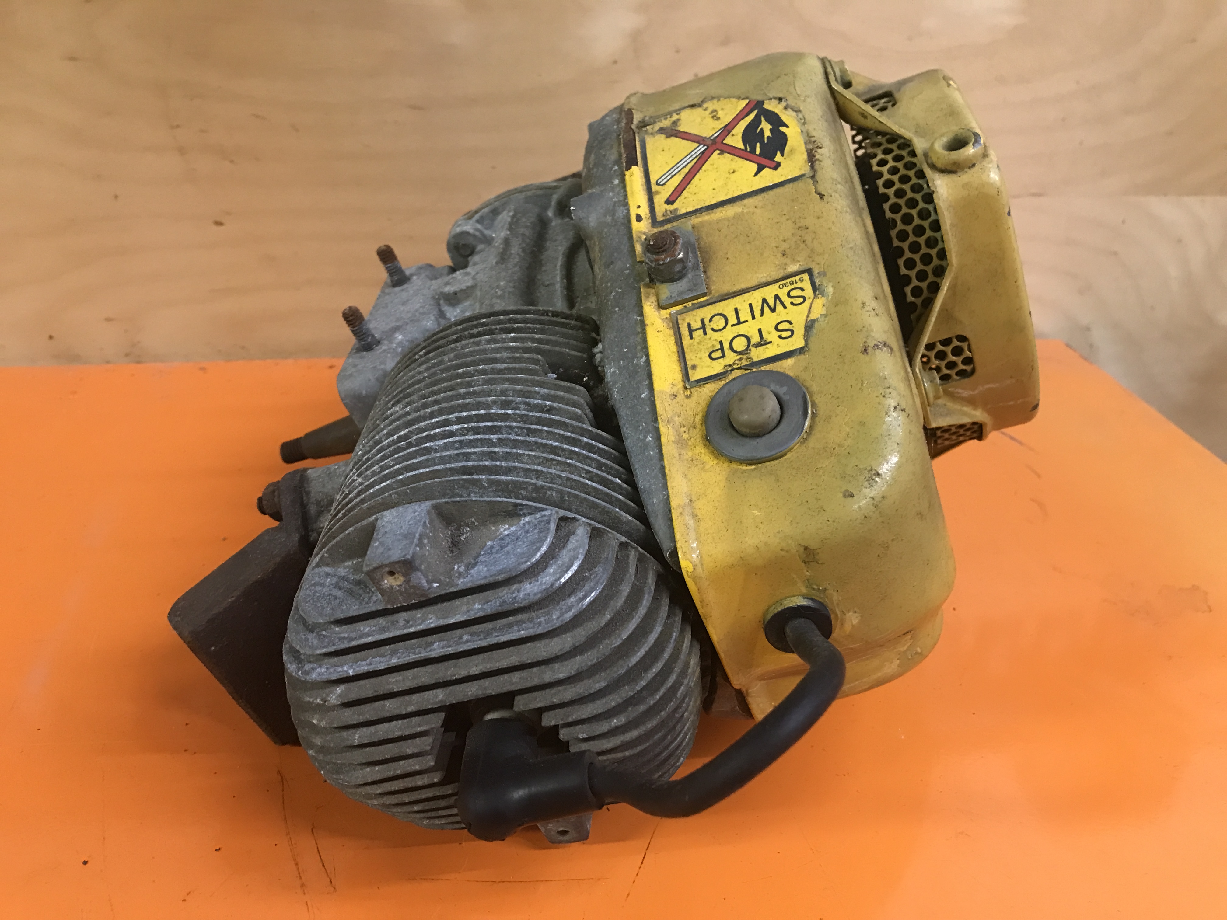

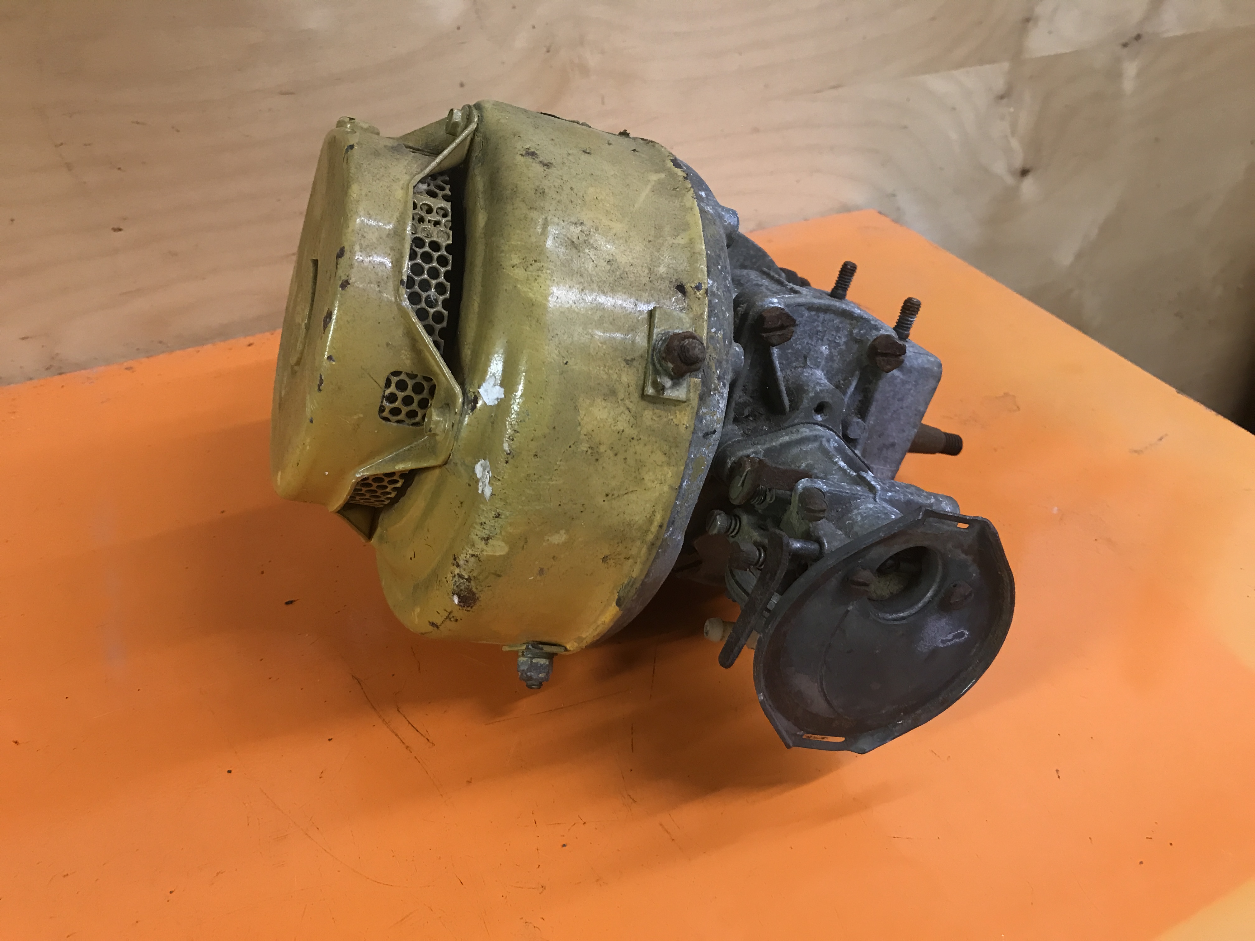

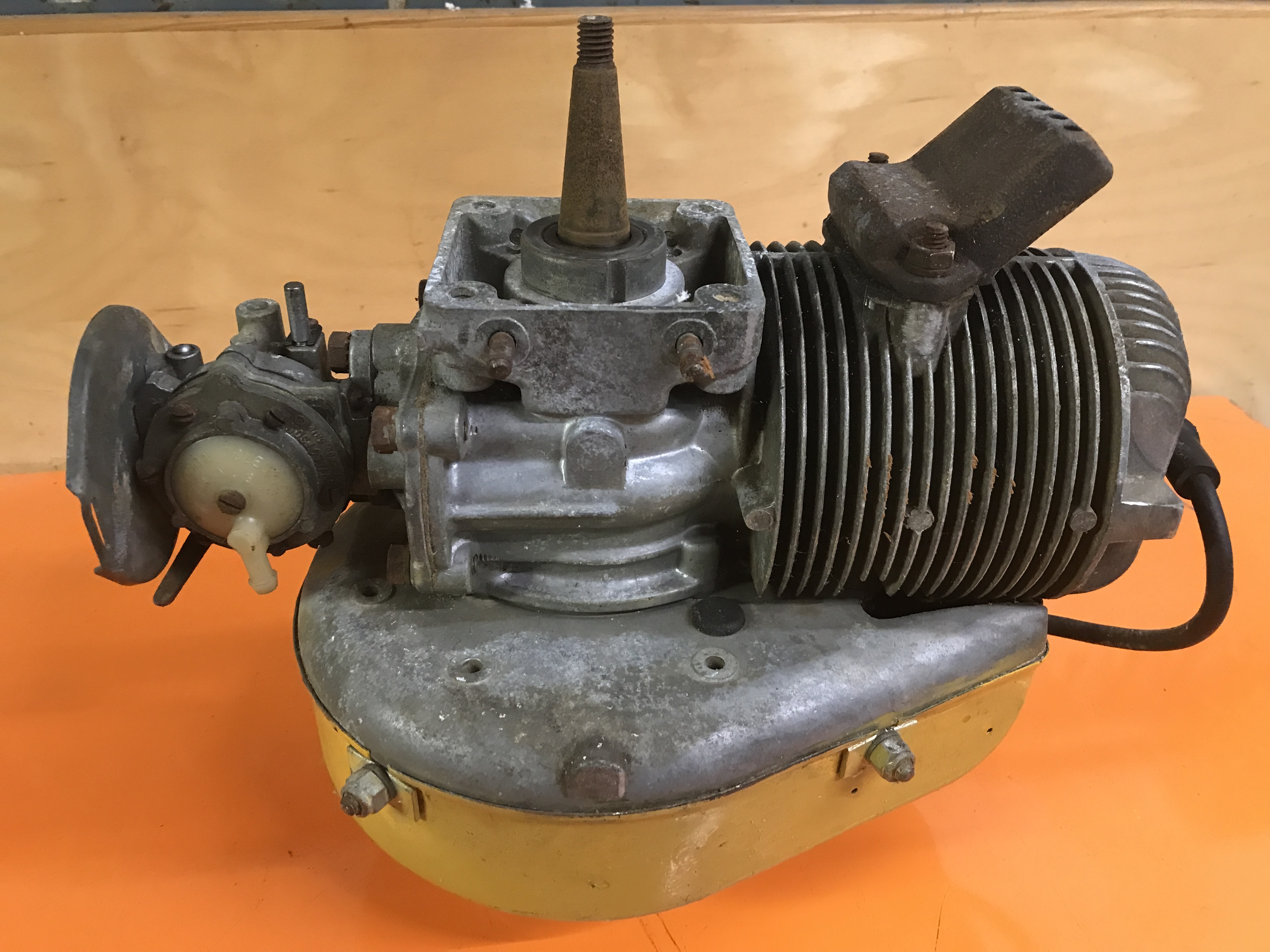

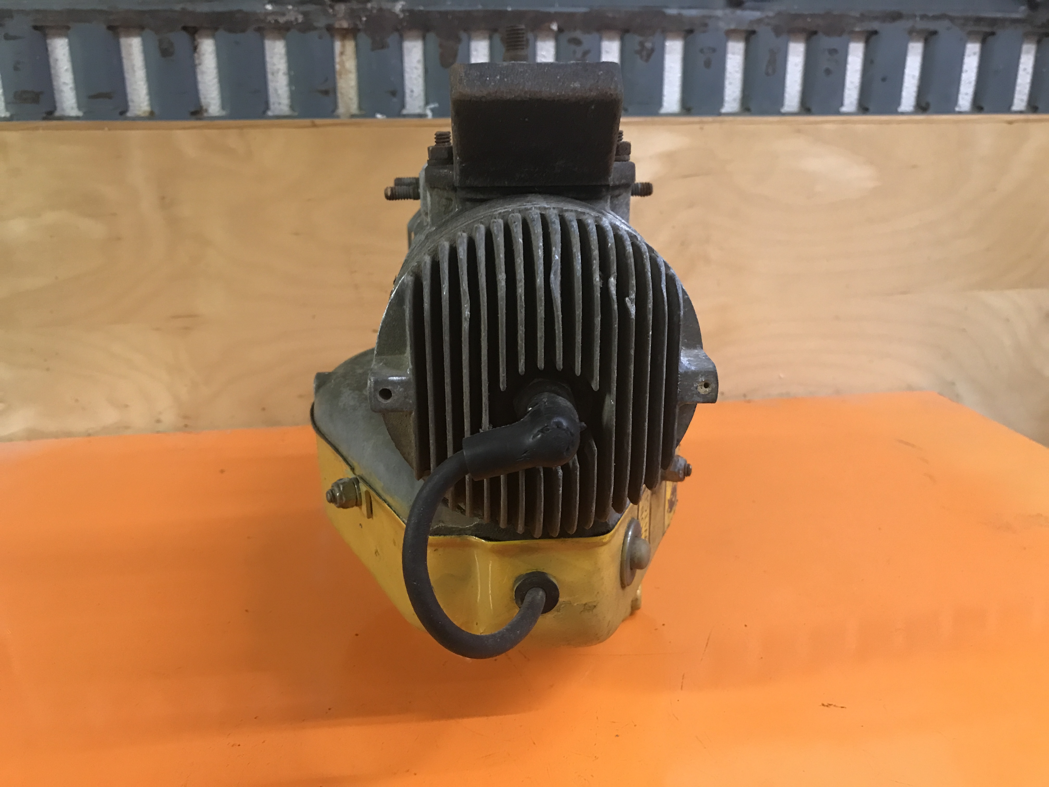

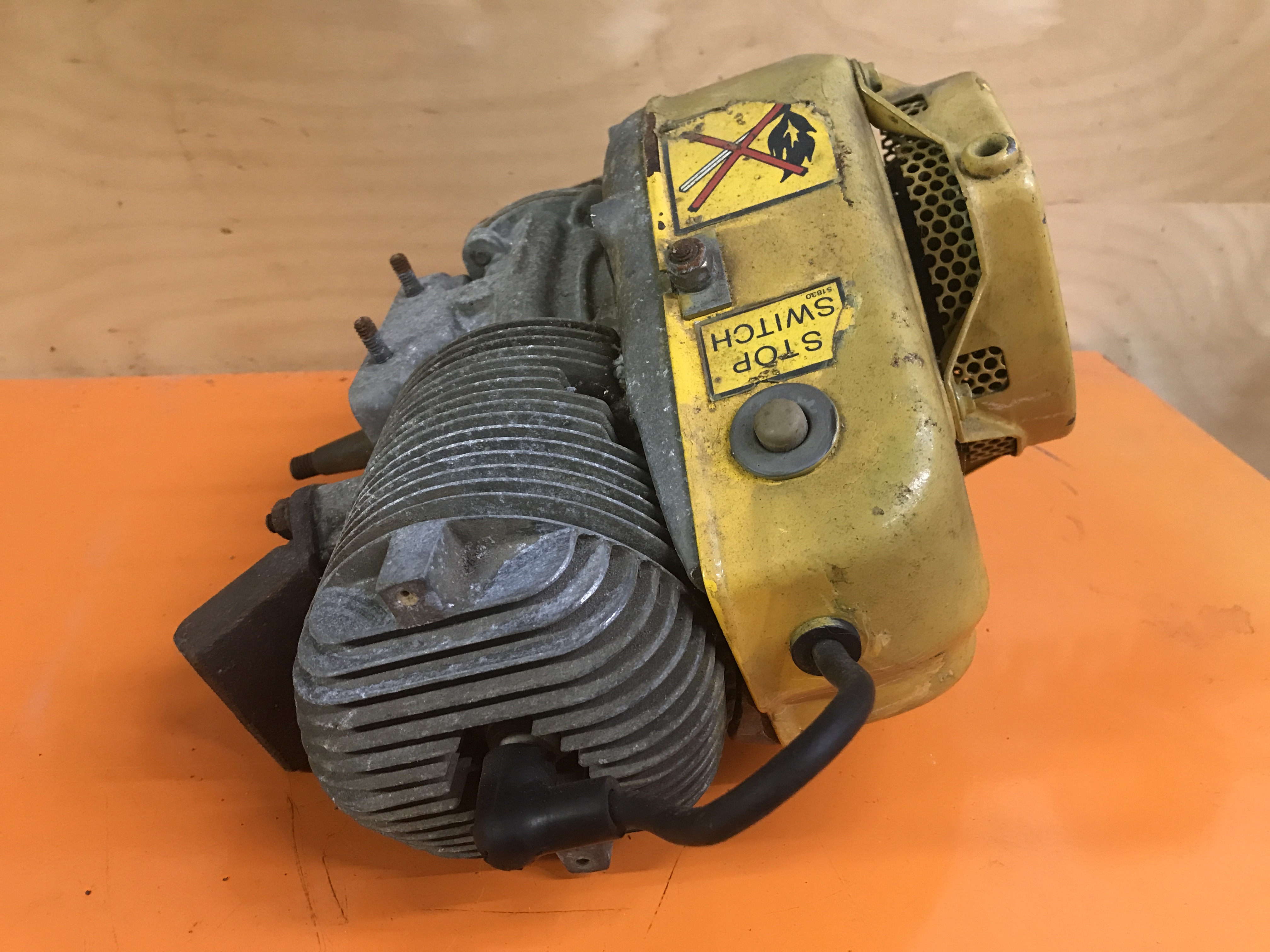

Post by Rich Lanyi » Wed Jun 18, 2025 5:00 pm
Is there any way to tell what model # a MAC is?

Post by Mark Loraine » Thu Jun 19, 2025 11:55 am
Lets start with West Bend 510, 580 or 700. many of the 4 digit models were small displ. used on various power equipment
5.1ci, 5.8 ci or 7.0 cubic inch
recoil style indicates a late production.
PTO taper is useless, rendering this motor as part machine if its intent is for vintage karting.
Gentlemen, fill in the blanks here for me.
Mark L. / SWNY

Post by REAR » Fri Jun 20, 2025 5:51 am
There is some good parts there minus the crankshaft as Mark said.
Someone could use this engine.

Post by Rob Voska » Fri Jun 20, 2025 3:04 pm
Take off the exhaust. If the bore is chrome it's a 700.

Post by Mark Loraine » Fri Jun 20, 2025 4:36 pm
A reminder of what I posted years ago about the ribbed crankcase blocks.
It was said that they were aluminum/chrome bores, which I found to be inaccurate, as I had one here and it was definitely a cast iron liner block.
I would have to assume it’s a 5.1 cubic inch block until otherwise determined.
