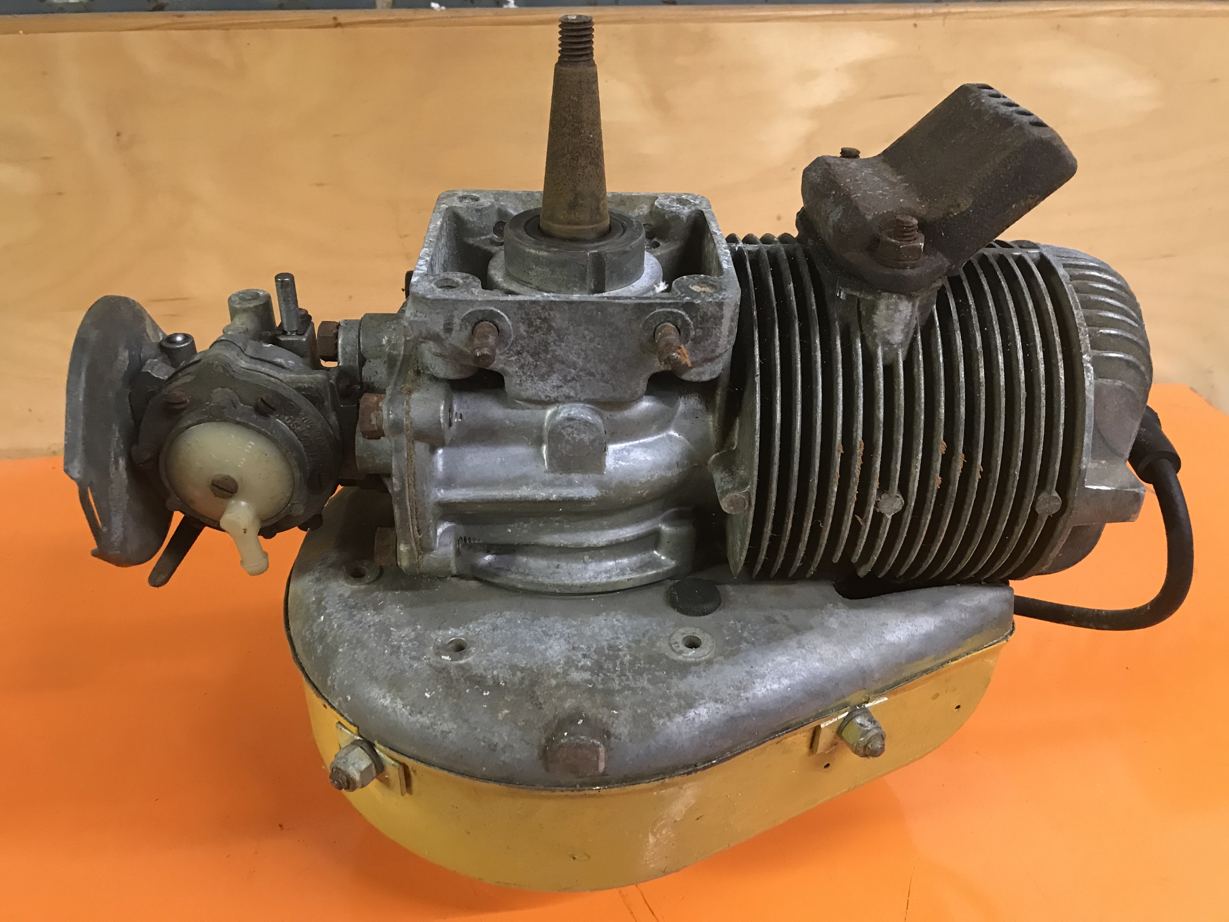

Is there any way to tell what model # a MAC is?
MAC Model # ??

Lets start with West Bend 510, 580 or 700. many of the 4 digit models were small displ. used on various power equipment
5.1ci, 5.8 ci or 7.0 cubic inch
recoil style indicates a late production.
PTO taper is useless, rendering this motor as part machine if its intent is for vintage karting.
Gentlemen, fill in the blanks here for me.
Mark L. / SWNY

There is some good parts there minus the crankshaft as Mark said.
Someone could use this engine.

Take off the exhaust. If the bore is chrome it's a 700.

A reminder of what I posted years ago about the ribbed crankcase blocks.
It was said that they were aluminum/chrome bores, which I found to be inaccurate, as I had one here and it was definitely a cast iron liner block.
I would have to assume it’s a 5.1 cubic inch block until otherwise determined.
Mark L. / SWNY
Mark L. / SWNY
